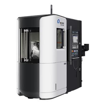

N2-5XA – Five-Axis Horizontal Machining Center
The N2-5XA has been redesigned to incorporate features such as the Pro6 control, a 36-tool magazine with separate loading station and co-located HMI, and more range of A-axis motion. The spindle in this agile machine features a 20,000 RPM top speed, standard 320 psi through-spindle coolant, and a rigid HSK-A40 tool interface. The floorspace required by the base N2-5XA is only 54 total square feet, or approximately half of the area required by a typical 400mm pallet conventional HMC.
