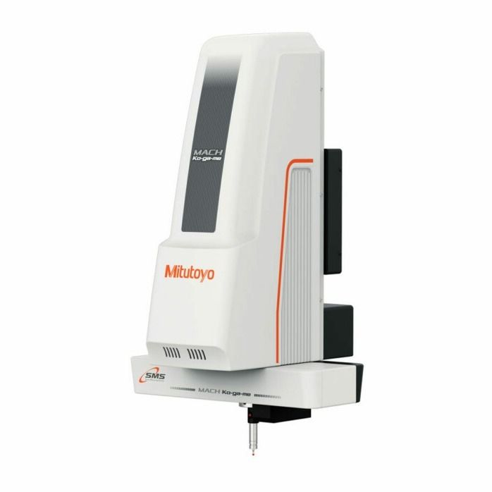

The Mitutoyo MACH Ko-Ga-Me is a fast, compact, lightweight and easy-to-mount Coordinate Measuring Machine, ideal for automated cell measurement solutions. The MACH Ko-Ga-Me can be mounted on any rigid frame, including machine tools, providing full CMM capabilities without the space requirements of a full-size machine. It also offers in-process measurement without requiring setup or breakdown. - Ideal for small workpiece inspection - The MACH Ko-Ga-Me accommodates a wide choice of measuring probes including touch-trigger, optical and scanning types - Load pieces manually or robotically for an automated closed-loop control process - Quicker measurement feedback and compensation of the manufacturing process reduces scrap and increases throughput - Temperature compensation guarantees accuracy within 4 different ranges: 19~21°C, 15~25°C, 10~30°C, 10~35°C
