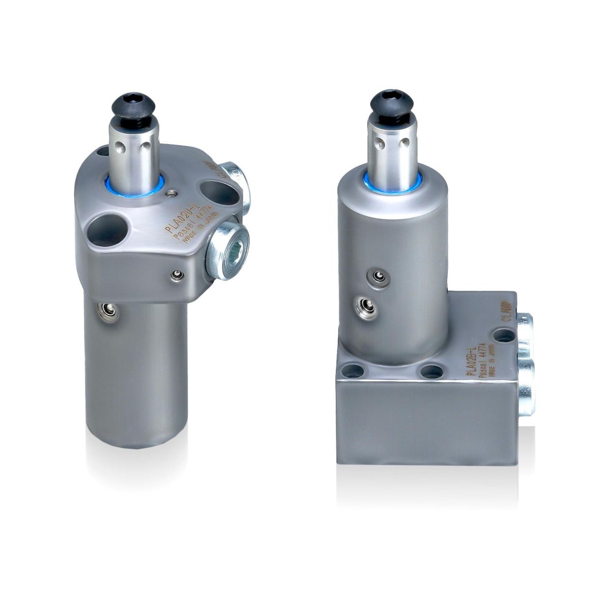

This sturdy hydraulic swing clamp can be used in lieu of its competitor without the need for jig modification. The PLA supports 440 to 3200 lbs. of cylinder force with a swing speed that is 50% faster. The PLA features a special rust-resistant Ion Nitride coating which makes it extra durable unlike its competitor counterpart which has an black oxide coating that peels and rusts easily. It incorporates 3 radial gothic arch cam guides for accurate arm positioning and longer life. Repeated clamp positioning accuracy ±0.5°
